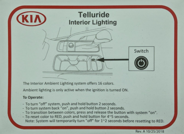

2022 Telluride sx nightfall with everything. When I got the car was able to set ambient lighting to bike. Now it is red, I did not change it, and I cannot change it back to blue. The ambient lighting controls will not change the color. Please assist.
89
32
SW MO
Are you referring to the ambient lights (strips on the dash and doors) that’s controlled via the infotainment screen, or the accessory interior light kit (cupholders and front footwell) that’s controlled via the button in front of the cupholders?
