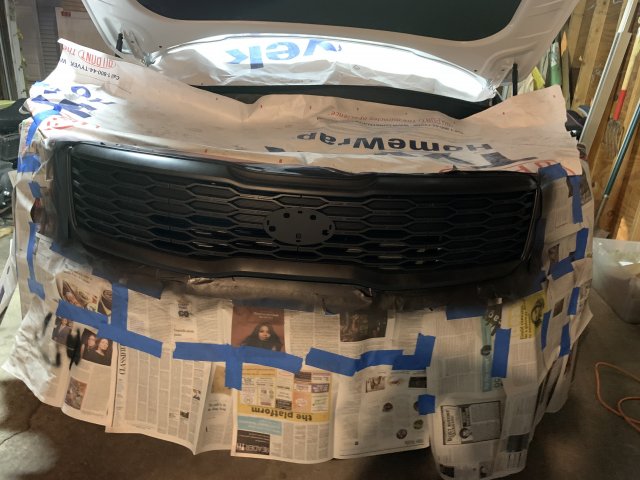

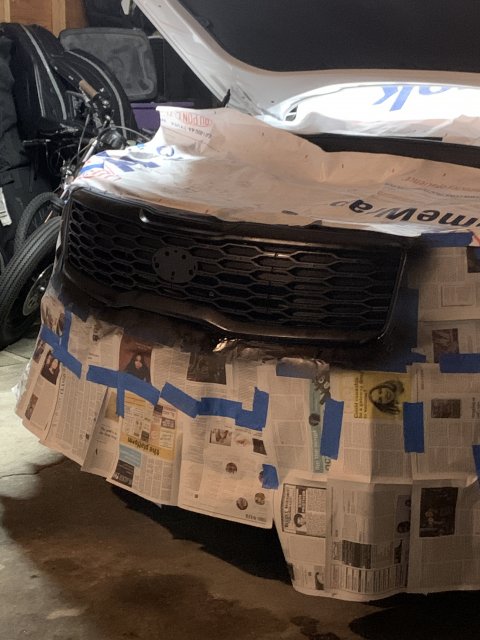

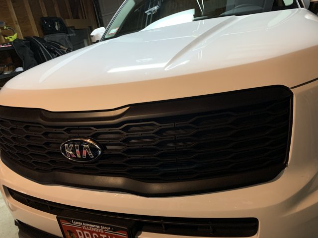

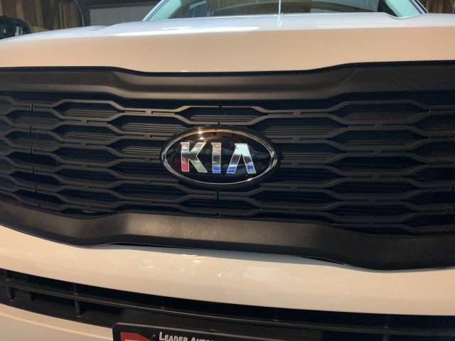

Finally had some time to dip my Telly grille! I saw a video on YT of a guy applying the dip with the grille still on his vehicle, so I said why not vs. remove the grille, dip, reinstall. So, here’s what I did in a nutshell:
First I removed the badge, was pretty easy. I used a tool for bicycle tube installs, worked perfectly and popped off safely.
Then I masked near the grille edge and then used newspaper to mask the front end off. After all of it, I still had some minor overspray so heads up on that. No biggie, it wipes off easy.
Next I sprayed a light first coat. I don’t like chrome so I did the entire grille. After 30-40 min Each coat, I did some heavier applications while keeping it nice and even.
Lastly I snapped the badge back on, pulled the masking tape off and pulled off the excess dip.
Here’s some detail shots, I’ll post a bit further away pic tmrw. Sorry, my garage is a wreck right now haha.

How did you keep from getting spray into the radiator? Did you put something behind it?
35
Chicago, IL, USA
#20
Hey, there's only 2 areas where the spray can get through.. the rest is solid plastic. I made sure not to spray those areas as close and did lighter layers from further back. Otherwise, all is good.
