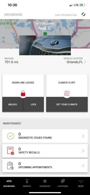

Thank you for your reply. I have done everything it states in the manual, also turned off both front and rear climate control settings completely. It turns off for varying and intermittent periods of time, and then turns itself right back on. My UVO only unlocks and locks the doors, as I have the S model without the remote engine start function. Nothing works. :)
The S has remote start, it's under Climate Control on the app.
