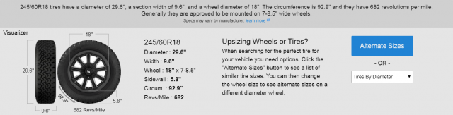

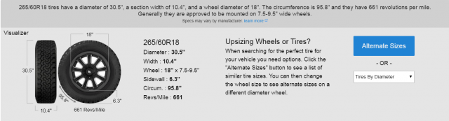

Here are some basic tire specs - need to verify with your actual tire brand
307

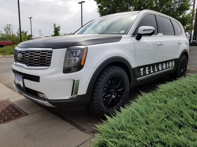

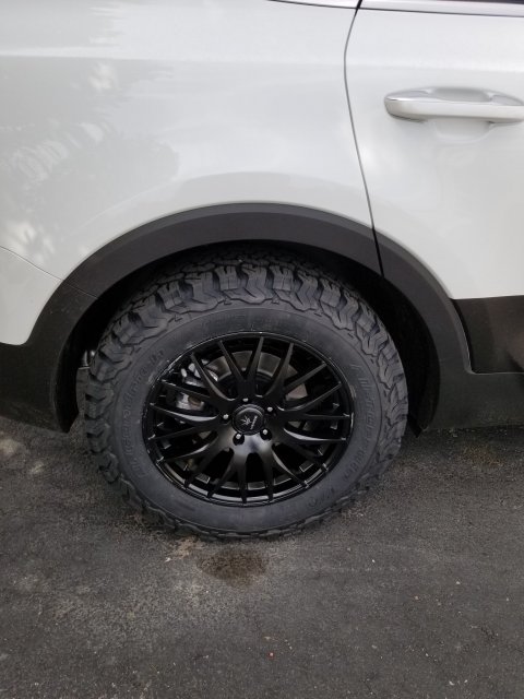

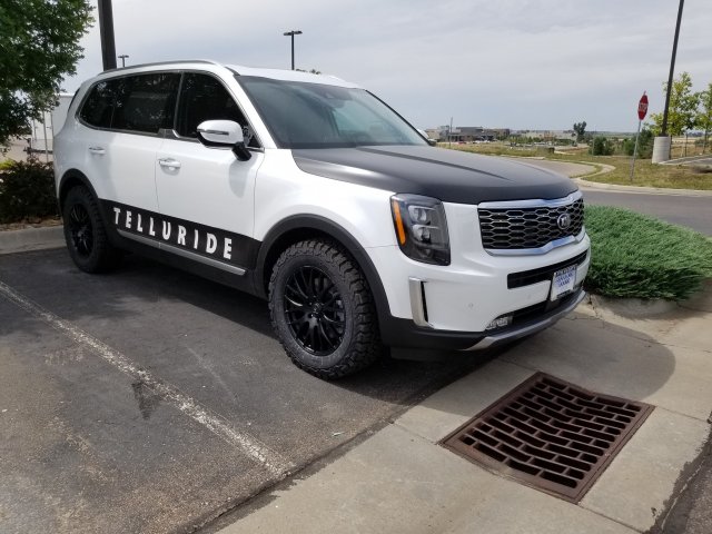

@bogiediver provided some great info. Yes you can fit 265/60R18 on the Telluride but it depends on the tire brand, wheel width and offset as some tires may run wider than others.
Here's an example of the fitment.

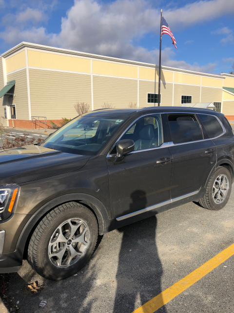

Finally got those tires mounted, here's a pic. They fit well and are less noisy than they were on the Durango for sure! Couldn't resist the flag and my shadow....
