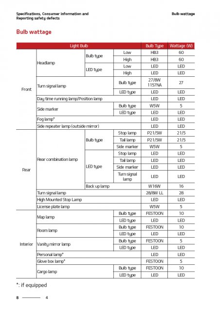

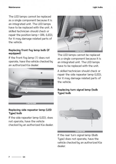

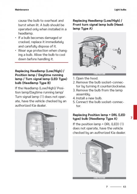

It looks fairly easy according to the manual. The DRL aren't replaceable but everything else is.
Headlights are HB3 60 watts, front turn signals are 1157NA 27 watts.
