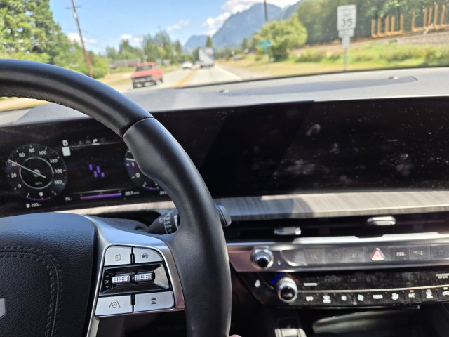

On a 2023 Telluride the infotainment screen is blank. Center of the main display has bouncing purple rectangles. See attached photo.
Ideas??? Fuse? Something more severe?

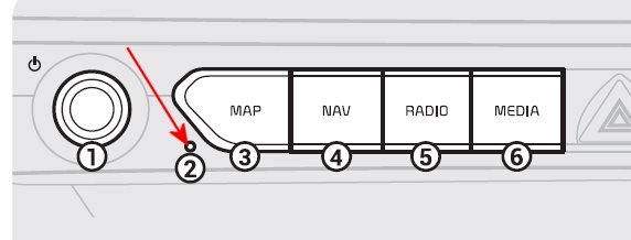

Have you tried pressing and holding the Infotainment reset button? You'll need a toothpick or the end of a paperclip to press the recessed button.

Trying this next
