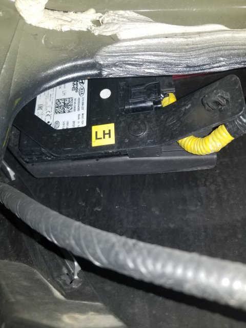

This area is not well protected and there is other wiring and some type of module (with the LH sticker on it). May be worth cleaning/inspecting regardless.
