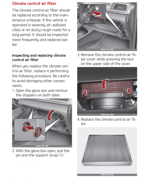

The cabin filter is so cheap and you can easily do it yourself it's not worth bringing to the dealer, it'll take you less than 15 minutes to do.
