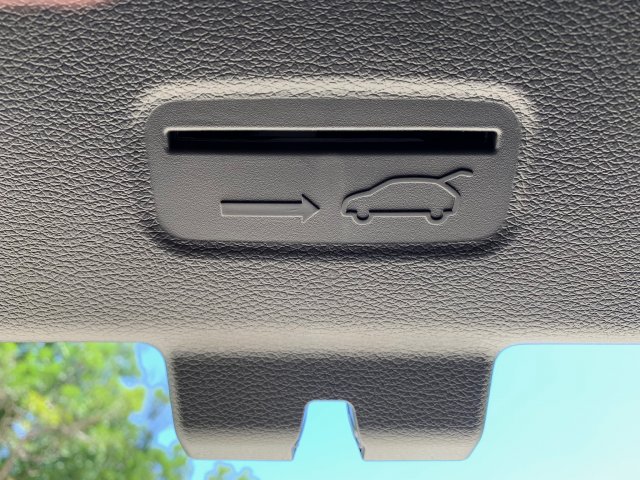

We took our week old Telluride camping this weekend and couldn’t open the rear power liftgate this morning. When we tried from the remote outside it would just blink the outside lights at up and beep but the gate wouldn’t go up. From inside the car with car running or without when you held food the interior liftgate button the hazard warning light and both the left and right turn signal indicators inside would flash but the gate still wouldn’t open. I was able to crawl into the back and manually open it by sliding the key in that slot on the inside of the rear hatch. That opened it.
Once open I closed it again but again it wouldn’t open with the rear button, remote or the inside button. A left it for an hour or so then magically it started working again as it should.

I had no idea that there was an interior key slot in the hatch for release. I haven’t any issues with the hatch.

No problems here either and I too wasn't aware that you can use the key for the hatch.

Today I looked in the hatch and did see the release slot at the very bottom ... good to know that this is here in case of emergency.

Last couple days our rear lift gate has completely refused to open. Button on key fob, button on the rear lift gate itself and even the button inside the car, none will open it. Car just flashes it’s lights and beeps three times then nothing. Only way to open it is to crawl inside and use the manual release on the inside of the lift gate and then manually push it open. Even after doing that it still won’t open or close electronically. Looks like there’s a dealer visit on my near future. Too bad I was just there doing the 7500 mile service last week.
