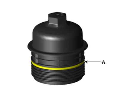

Just to be sure - are you putting the O-Ring in the right position? Also, is there any impediment where the body of the filter cover connects with the engine? Did you coat the O-ring with engine oil?
Tightening torque : 31.4 - 38.2 N·m (3.2 - 3.9 kgf·m, 23.1 - 28.2 lb·ft)

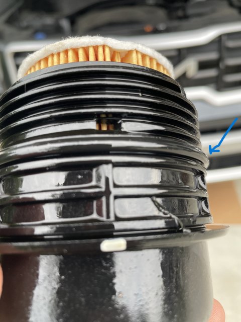

Thanks for picture --- but is gasket on the 1st thread course or above the threads? Picture makes it look like it's above the threads all by itself. If it is on the 1st thread then of course the gasket has to cross over the thread ridge so that's where I'm assuming its leaking at.

Thanks for picture --- but is gasket on the 1st thread course or above the threads? Picture makes it look like it's above the threads all by itself. If it is on the 1st thread then of course the gasket has to cross over the thread ridge so that's where I'm assuming it’s leaking at.
It is above the thread. If you look the last thread had a tiny hole the o ring goes right above that one. Also coat the o ring with oil.
It is above the threads in a groove designed for the O-Ring. Please remember to coat the full O-Ring with engine oil. I hope that helps!

I see the small hole now, thanks. New o ring now sitting just above the thread. But still a very very small leak --- once every 6 minutes (a big improvement from before but still not right). Tightened to 25 Nm.
