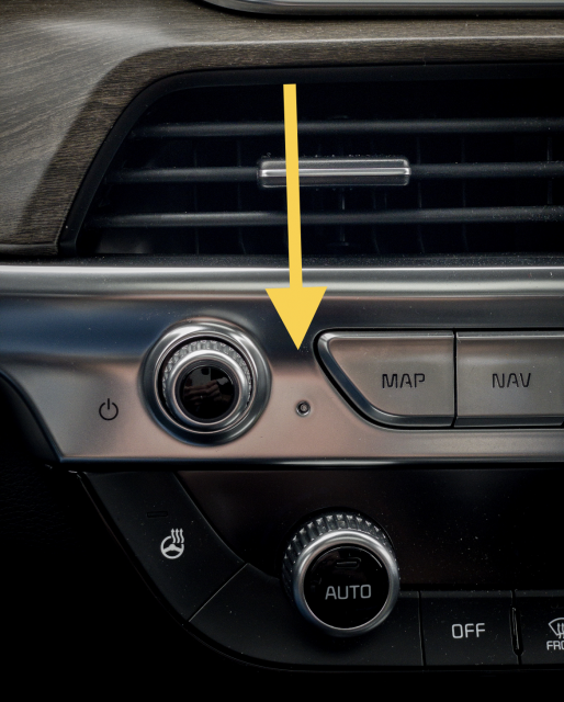

Usually just hitting the infotainment reset button with a pen tip or paperclip should be all you need to do.

Haven't had the problem since. Good to know about that reset button.
