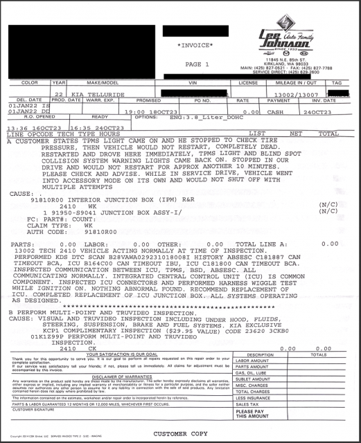

Today, while driving my 2022 Telluride EX (13,000 miles), I received a Tire Pressure Monitoring System (TPMS) alert. Upon checking the menu, the tire pressure didn't display. I stopped to inspect the tires, and all appeared fine. However, I then faced a series of electrical issues:
  • Transmission Lock: The vehicle wouldn’t shift out of park.
  • Unresponsive Start: After shutting down the engine, the car wouldn't restart. There was no response when pressing the start button.
  • Partial Electrical Functions: While the dash and infotainment screens remained non-responsive, overhead lights and interior power door locks were operational. The key buttons also didn't respond.
  • Unexpected Illumination: After about 10 minutes of inactivity, the dashboard lit up on its own, even though I made no attempts to turn the car on at that time. Once this occurred, I tried starting the car, and it powered on immediately without any indication of a weak battery.
  • Further Alerts & Issues: While driving to the nearest dealer (roughly 10 miles), the TPMS alert showed up again, and the infotainment screen then powered off. A few minutes later the blind-spot-collision warning alert was received. At the dealership, the transmission lock and restart issues reoccurred.
The dealer couldn't immediately pinpoint the cause and plans to delve deeper into the issue. Interestingly, after about a 10-minute conversation, the car repeated the behavior outlined in the "Unexpected Illumination" section above.
Has anyone come across this or have any insights into the potential problem?

Just dropping in to give an update on the electrical issues I experienced in case someone else runs into a similar situation. After seeing similar instances on this forum and other forums with no clear resolutions, I thought it'd be helpful to share my findings.
The root of the problem was a malfunction in the Integrated Central Control Unit (ICU) Junction Box. You can refer to the attached image of the invoice for specific part numbers and further details. It took the dealership 2 days to diagnose the problem and an additional 3 days to secure the required part. I picked-up my car last night, and as of now, it's operating smoothly.
I'll be sure to post any further developments, should they arise. I truly hope this information is beneficial to someone down the line. Safe driving!
