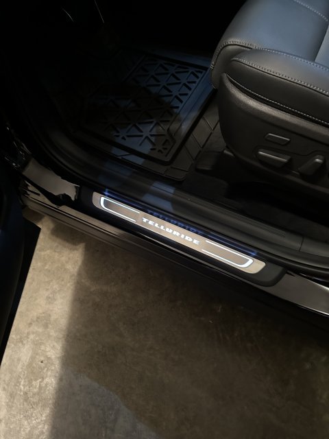

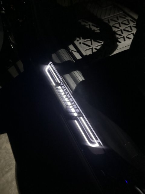

I recently purchased a 2024 Kia Telluride SX. I wanted to install the Kia Telluride illuminated sill plates but the manufacturer only had them listed for models 2020-2022. What about 2023 & 24? Couldn’t get a straight answer so when I found some on closeout on a website I took a chance and bought them. $150 shipped.
The instructions are very detailed and have nice pictures. Total job took 2 hours. So yes, the illuminated sill plates WILL fit models 2020-2024.
Now, the instructions tell you to splice into certain color wires on the wiring harness. Those colors were WRONG on my 2024. What you have to do as the instructions state is go by the Pin connector tab # (they have good pics) and use that color wire no matter the color. For example, the instructions state to attach to a grey wire at pin 32 on the wire harness. My pin #32 was a red wire. Just have to be sure to follow instructions closely and look at the pin and buss connectors…. Not the wire colors.
Now for a 2020-2022, i’m sure the wire colors are per instructions. They must have changed in 23.
