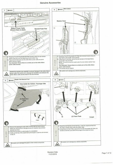

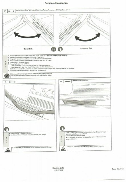

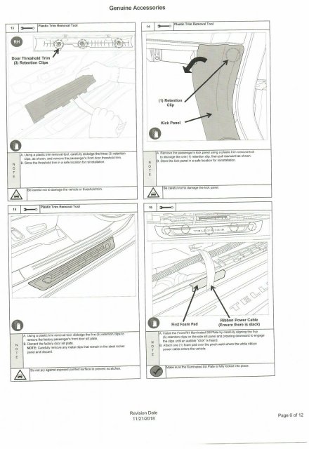

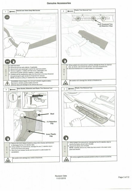

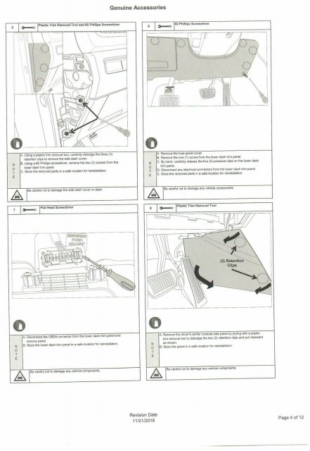

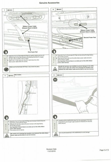

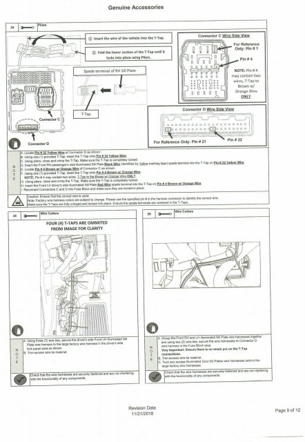

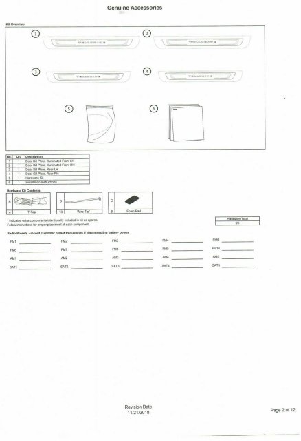

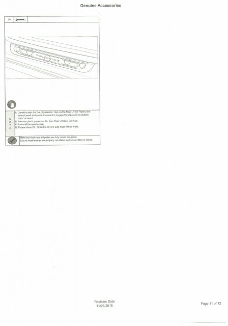

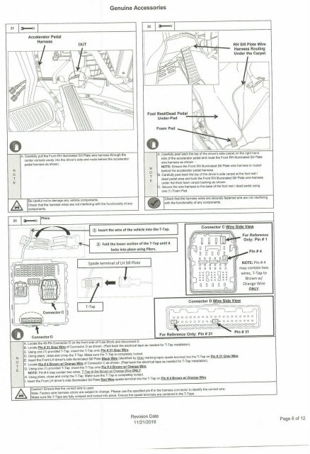

Big thanks to @mrojas7419 for provided these Illuminated Door Sill Plates installation instructions
