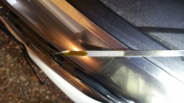

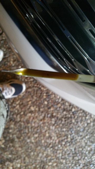

Have a 2021 telluride and upon checking the oil after an overnight sit the dipstick shows to be on the low mark but after wiping and reinserting it shows to be at the full mark?? Anyone experience the same? I've never encountered this in the many years of checking oil on my vehicles.
