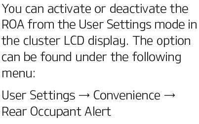

That is probably it (Rear Occupant Alert - ROA system)… it is disabled using the menu on the screen behind the steering wheel:
From page 4-22 of the user manual:
Thank You it is now disabled. Yes it is confusing...thanks for your detailed answer.
