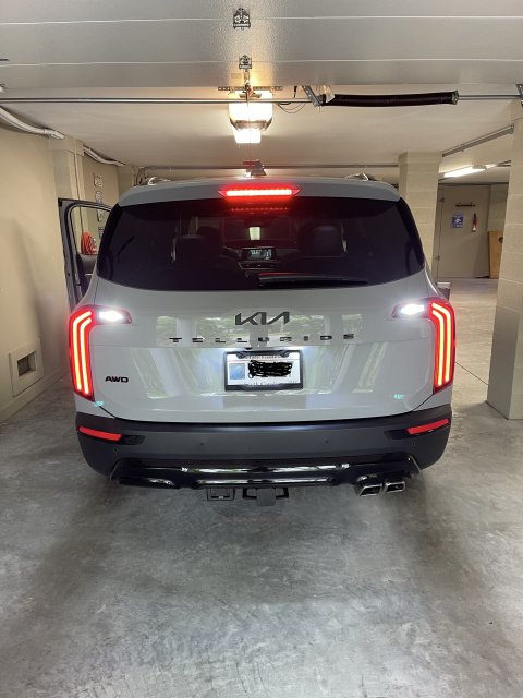

I replaced my reverse lights this past weekend. It took a while and the driver's side was a pain in the arse. You have to be super flexible to get your hands around to get to the bulb. These are the bulbs I used. The difference is incredible. Beautiful bright white light projecting from the rear view cameras on the infotainment screen.

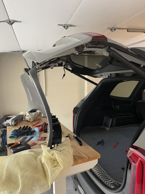

Then I took the plunge and did the rear backups. Purchased the Sunplustrade Auto Trim Removal set on Amazon for $10. You will need the thin needle like tool to create a gap to then fit the wide pry tool into position. I recommend you watch the Lasfit video multiple times, before and during the install, and pay attention to the subtle details of the disassembly and reassembly. Once you get the large rear piece off, you will find the video doesn't show that the rear hatch close button stays on the panel and hangs from the wire! I had to use my rolling worktable to support the entire panel and keep tension off the wire. Also be ready for the hatch to try to close as you manipulate the panel/close button. I took pics of the inside of the panel so I had a better idea where to later direct my hand thumps to seat the panel back into place. I used Auxito 912 921 LED (T15 compatible). Took about 45 -60 mins. Wasted 15 mins trying to locate where a small broken plastic piece came from when the large panel popped off...never found the origin so I figured it was leftover from factory assembly. Wife took pity on me and agreed to put the Telly in reverse during the install and at completion to confirm correct function lol. No error codes or hyperflash!
