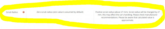

Thanks again for the knowledge bomb! The new wheels I’m looking at are an 18mm off set
Not sure what look you are going for but those will defiantly stick out past the fender (about 1 inch) and rub when you turn. One last thing is "scrub radius" +27mm further out, It's hard to explain but will effect the handling, especially if your Telluride is AWD. and it puts additional stress on the front steering and suspension parts.

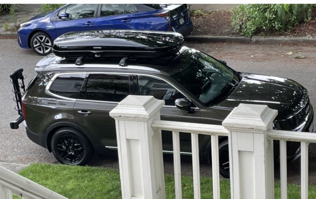

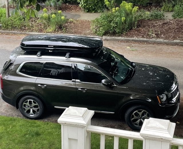

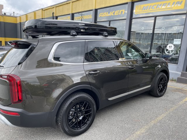

I’m in vancouver, Canada - have the EX in dark moss, here are my before and after pics! We went with “RTX Envy 18” gloss black” wheels, kept stock eom tires. This thread was hugely helpful for me - thank you all!

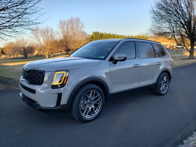

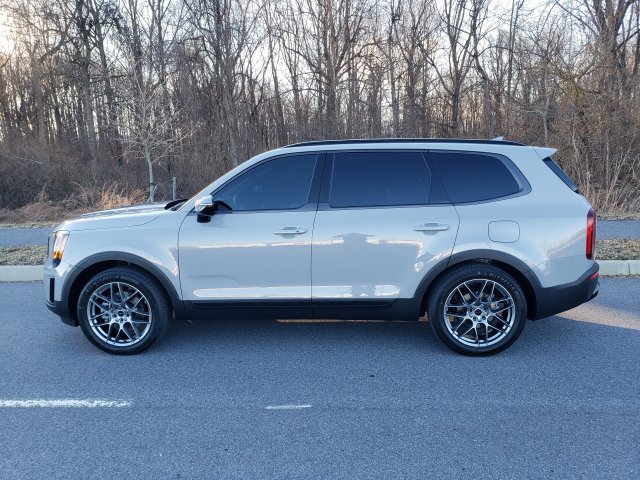

Ocean Springs, MS

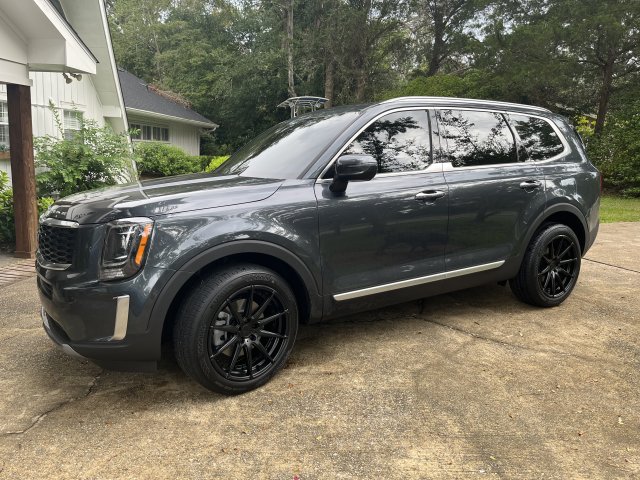

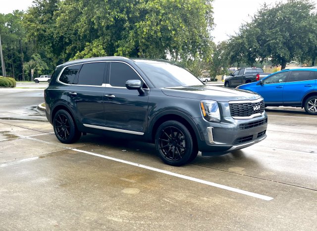

Just received our Telluride last week, had the new wheels put on today. Insignia Verde V20 20x9
Next to do:
Pirelli Scorpion 275/40R20
1” wheel spacers
M&S lowering springs
B74B733C-CC15-4F3F-A0BB-C5C5A69EC98B.jpeg 6FB6DFD6-2313-4992-AD34-EFE89F897669.jpeg

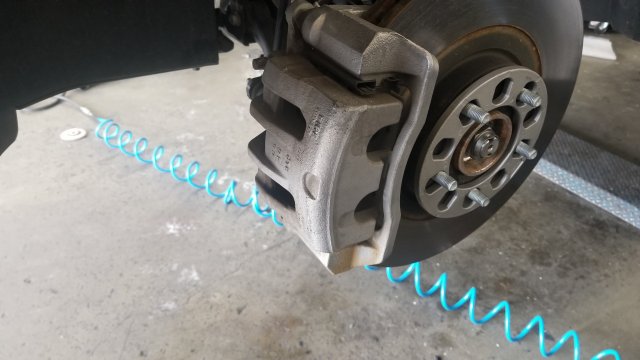

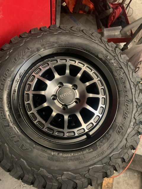

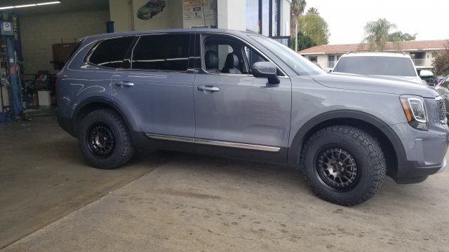

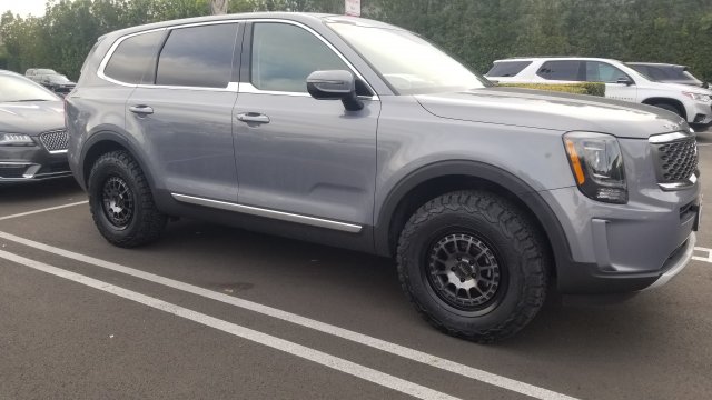

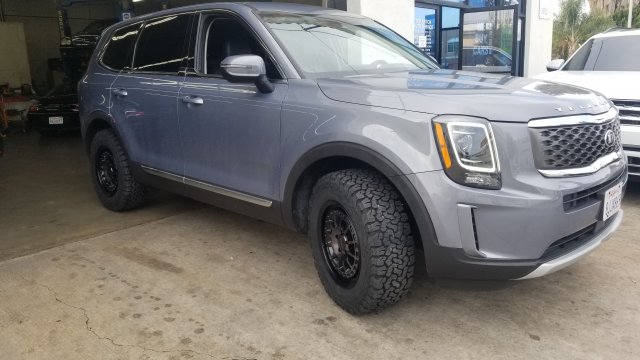

Finally got to upgrade my wheels and tires...
2" Eibach Pro Lift Kit
17" KMC Canyon in black/grey, +35 offset
265/65/17 BF Goodrich KO2's
10mm generic spacers in front wheels.

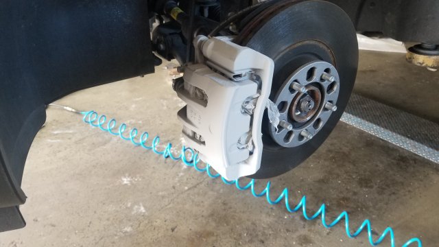

There were some raised letters on the front brake calipers that were digging into the inside of the rims, so the shop I went to had to grind down some metal, then coated the shaved calipers with anti-rust and primer.
Will replace the generic spacers with Eibach Pro Spacers (part# S90-4-15-018) next month, and add same spacers to the rear.
Caliper before grinding...
Caliper after grinding...
