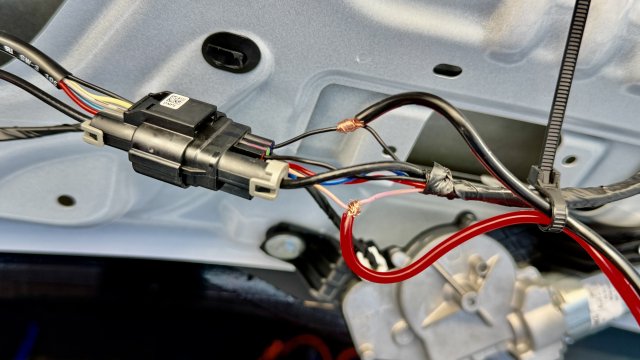

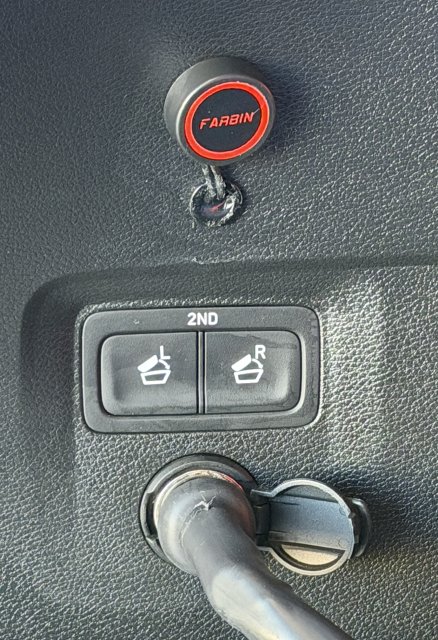

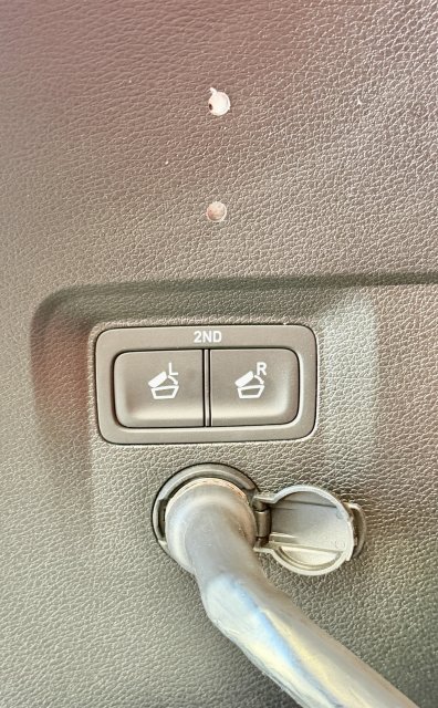

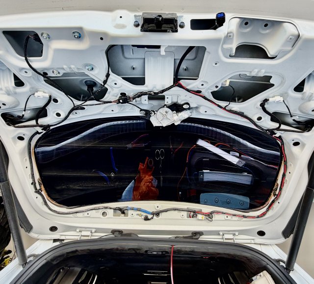

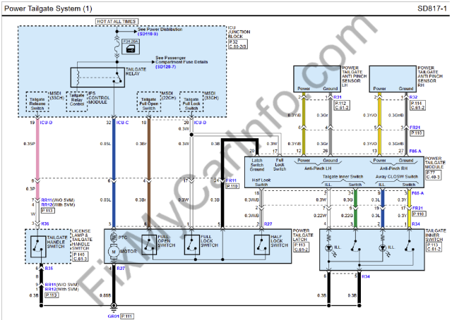

So just as the title is listed, I am going to add some entry and exit buttons on the inside of the vehicle in the rear for camping (i.e. sleeping in the vehicle) purposes in lieu of using the keyfob. I thought about this for quite some time but always used the keyfob and decided it would be more elegant to have a red colored exit button and a white colored close the tailgate button. (https://www.amazon.com/dp/B0BK4HDQHX?ref=ppx_yo2ov_dt_b_fed_asin_title&th=1 and https://www.amazon.com/dp/B0C36TVWJ6?ref_=ppx_hzod_title_dt_b_fed_asin_title_0_0)
Since I am going to be doing the 3rd brake light flasher module soon, and going to need to pop panels anyway, I decided 'why not'.

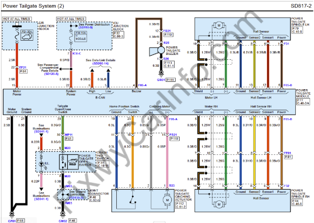

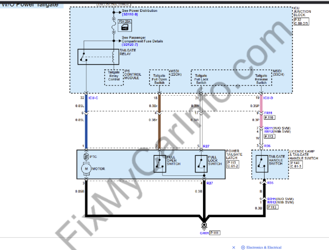

I'll post my progress and install on this over the next few days. Should be relatively simple to tap the hatch release and hatch close button with two separate SPST push buttons with some wiring and I'll mount them somewhere so they don't get bumped but is also deliberate in the need.
