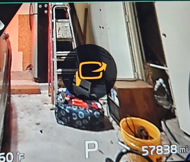

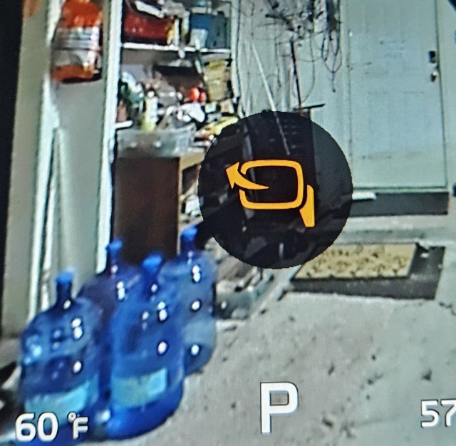

Can some one tell me what this orange mirror symbol that just started appearing on my 2021 Telluride when the turn signal is activated. I cannot find any information on it and I ask online at KIA customer service and they said, "we are not technicians, take it to a dealer"

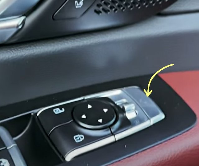

That symbol on the blind spot live video indicates that your vehicle thinks your outside rear view mirrors are folded inward (obviously from your pics they are not), and it's telling you to unfold them to the normal operating position. Did the mirrors recently get bumped or manually folded out of position? Try using the manual mirror fold button (forward most button on the driver's armrest) to fold them in and then out again a couple of times and then see if the symbol goes away when you use the turn signals.
