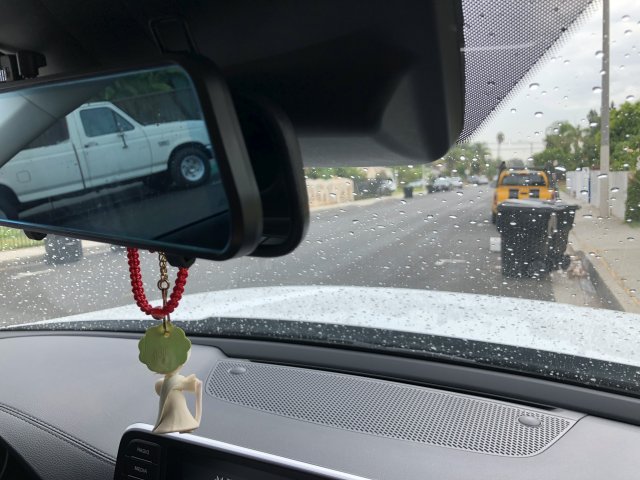

In case anyone is wondering, this is what it looks like installed on an S trim.

How do you attach the mirror to the windshield and was it easy to do ?
56
You remove the cover that's behind the mirror, it'll just pop out, then use a T-20 bit to remove the mirror. Then you slide the mirror off in an upward motion. It literally takes 5-10 minutes to remove the mirror.

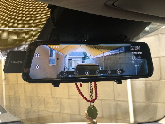

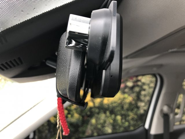

How about a BIG improvement adding a security recording Front/rear dash camera
Tell me, what you think?
Easy installation and of course has to be mount over your existing mirror
49
Looks great, is it getting power from the 12v outlet?
