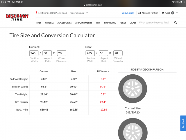

My guess is there isn't 2.51 inches of clearance but I'm also not sure the proper way to measure that. Fully turn the wheel and measure from tire to wheel well?
You read that incorrectly it is only .8 inches taller and .78 wider.

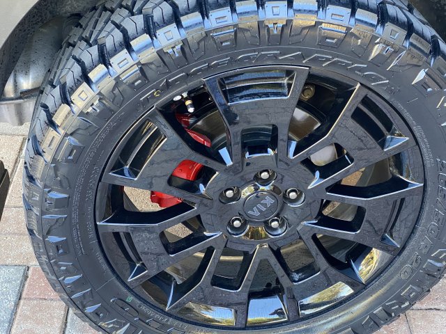

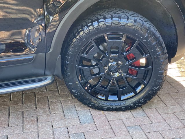

I installed Nitto Grappler 265/50 20 on the 20” Nightfall rims and added the Truxx 2” lift along with a 1” spacer. Here are some pics so you can decide if you want to do it.
That looks awesome. Does the lift/spacer impact the handling much? I'd love a bit more clearance for deep snow. Also, would there be an issue with the auto leveling tow package?
21120
Is the one inch spacer for the self leveling shocks in the rear? Looks awesome, does it still maintain the same ride?
