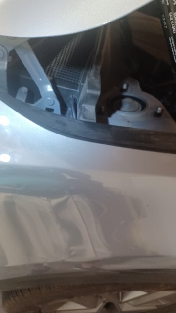

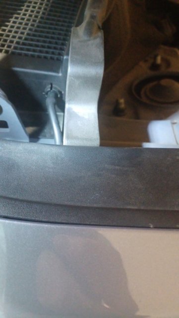

It really helped me to find a solution to this common problem. Some people have set repair appointments without checking this. After a full windshield replacement, it often happens that the technician fails to reconnect a small water hose under the windshield.In my 2024 Telluride, the washer motor didn't make a sound so I thought I'd blown its fuse. Safelite knew right away what to look for.That hose is on the passenger side below the window.
