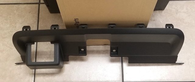

@xcelir8kia do you know if the Curt hitch would fit in the same slot as the OEM tow hitch bumper cover trim S9F61-AU060?
No. Yes. :)
The Power will if you get the metal plate adapter. The Curtis hitch sits lower and therefore there will be the gap above it in the new panel. Hence why I just did mine custom. Also, I am using a 2" $35 Curtis 'Rise' hitch that goes into the installed hitch receiver to make it like 'OEM' hitch receiver height.
