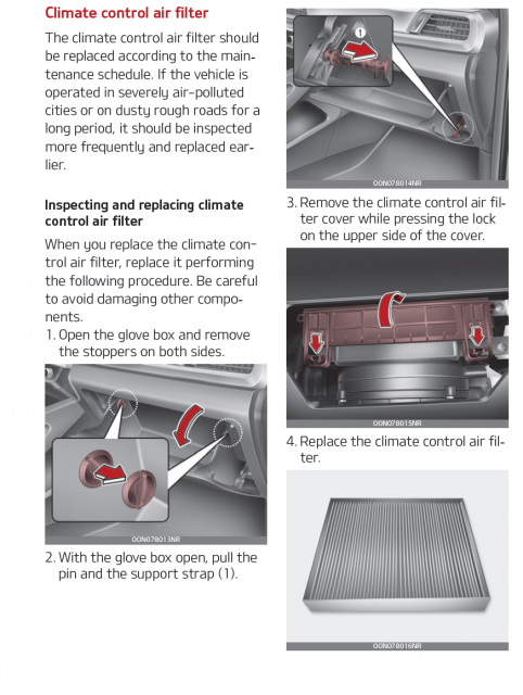

Its in the manual but I'd like to leave a copy here for quick reference.
This is how you change the cabin filter.

I think I remember seeing this in the maintenance schedule. It should be replaced at every oil change.

I normally replace the cabin filter every 15k miles.

I have a fowl musky odor which I assume is from condensation coming from my vents when I turn my AC on at times. Will this help alleviate that?
