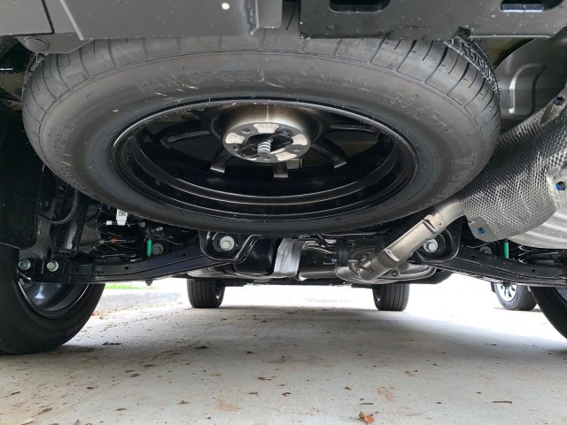

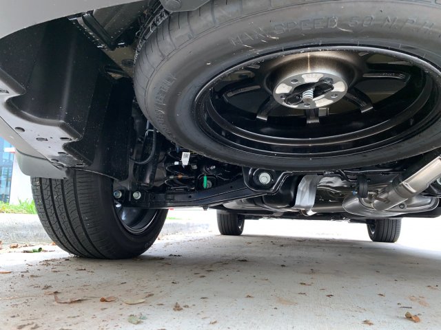

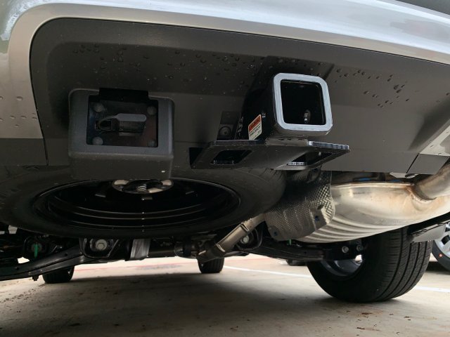

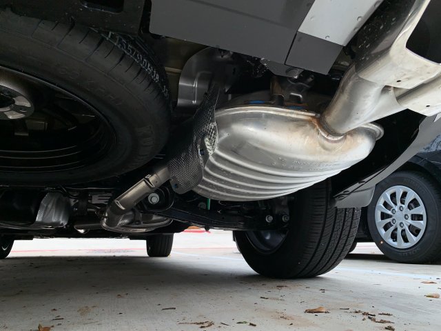

Will someone that owns one of the telle’s with the tow package please post pictures of the rear suspension from underneath.
I’d like to see what the rear leveling suspension consists of so I can somehow retrofit it. Please and thank you.

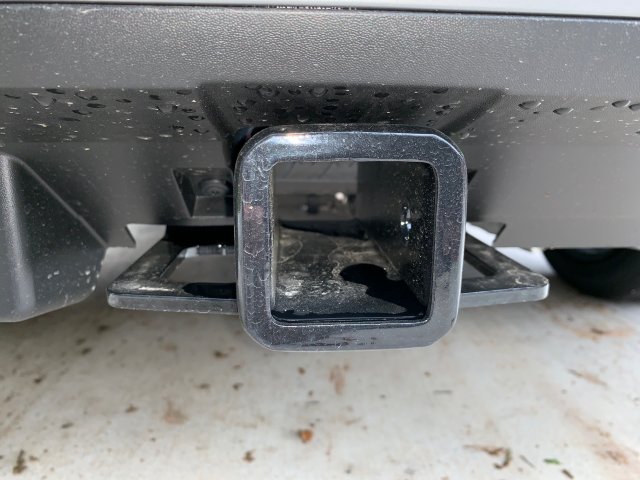

I can't see airbags. Unless I'm missing something. I saw there is a port installed hitch and harness (no air bags). Then EX and higher has the option of factory hitch, harness, airbags. Maybe this is the port installed variation?

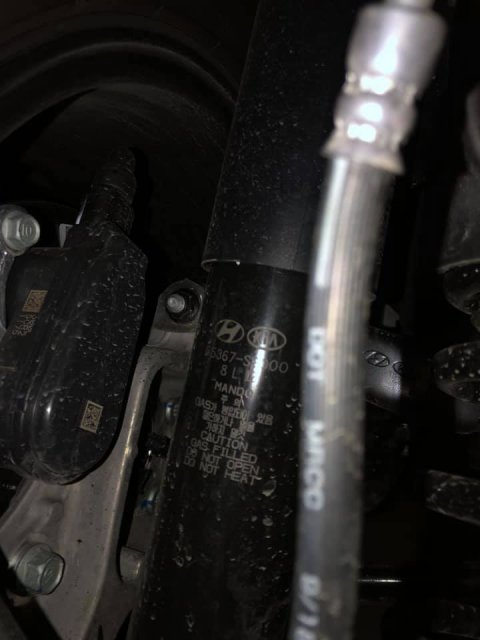

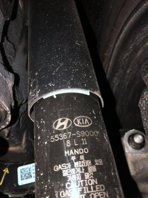

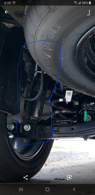

Looks like The adjustable suspension is built in to the shock/ struts. That’s good news, means the adjustable parts can be added on. I’m doubting there is much to change to retrofit them to the telles without them

I would not gamble that just yet. Because we are not able to see the type of device this is we can not make that call. Could be similar to a Gmc magnetic ride control leveling device, could be Pneumatic pressure.
