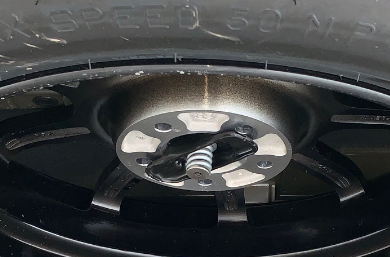

Unrelated question prompted by the photo of the spare tire under mounted. It's been ages since I've owned a vehicle with an undermount, but that one had a hinged bar under the spare which was an effective lever for lowering and raising the spare. Has anyone removed the spare and what do you do to keep it from falling onto you?

I believe it's like my (gasp) minivan of the past... it's a plate under the spare wheel, (close up of a pic from earlier in this thread)
connected to a cable that's lowered by accessing a bolt head inside the hatch which uncoils (for lowering) or coils (for raising the wheel). The cable on the minivan was long enough that when lowered, it was possible to slide the wheel out from under the vehicle - then reassemble in reverse order.
