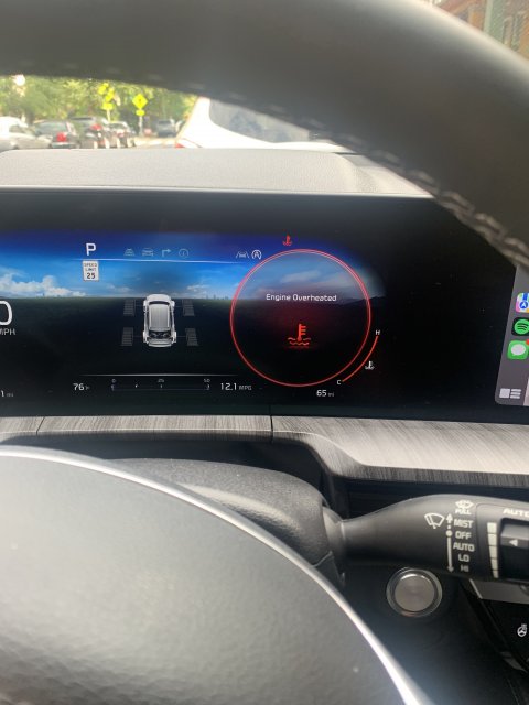

Engine overheated warning on my 2024 SXT Prestige with 65 miles on a 76 degree day. Happened after about 45 minutes of driving in moderate traffic. Drove it to the dealer the next day. Will report back with what they tell me
Dealer believes it was air pockets in coolant system but they could not replicate the issue. Hoping they got burped out.
Dealer got it to act up after it happened to me when letting the car idle for a couple minutes. They believe it's the thermostat assembly. But due to the low mileage they have to get the engineers involved and let them know. 2024 telly with 6k
