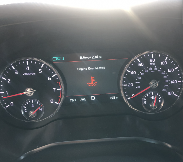

I just purchased my Kia Tellurside SX Prestige package on May 18th, after only 794 miles, I received the same message while in a drive-thru line. I plan to take it to the dealership later today.

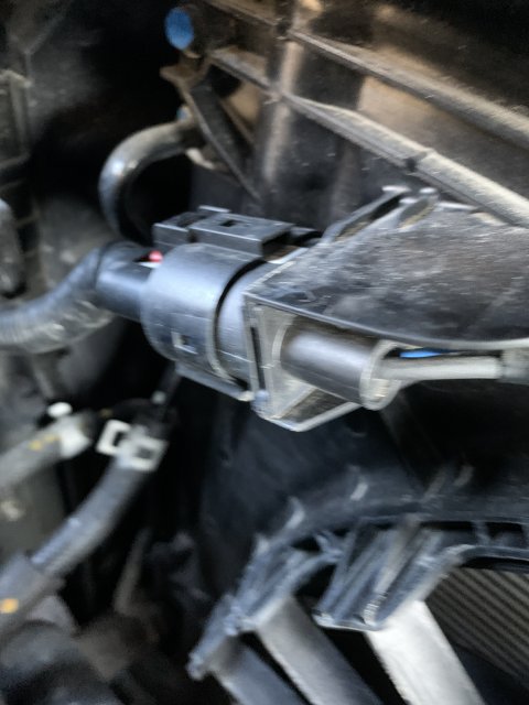

Happened to me, was a disconnected (or never connected from the factory) Fan cable Connection. Isn’t an issue when driving at speed but when idling it overheated. I wasn’t shown where the connection was, but You might be able to check all the cables leading to the fans if you’re handy. Otherwise, this appears to be an issue for a TON of people and I’m finding it is the same across the board. Whoever was in charge of connecting that cable really hasn’t done their job. Good luck with yours!
Thanks @GravelRox27 your post helped to point me in the right direction and discovered I had the same issue. Pushed the cable in real good and PRESTO! fan starts working and idles exactly at 203F, instead of climbing up to overheating.
Check this connector (pic below) if you have overheating issues. Squeeze it together real good or just pull at it to see if it comes apart. If it comes apart, then that means it wasn't connected properly since when it's right, there should be a connector lock engaged to keep it from sliding apart.
