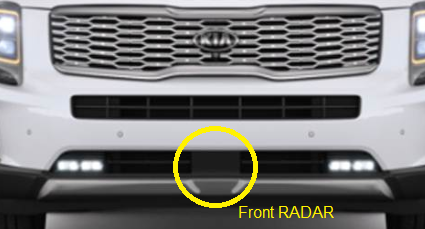

Assuming the FCA system is ON and you still get the warning, the dealer has to not only check the camera but also check the front RADAR since it uses both the Camera AND front RADAR
