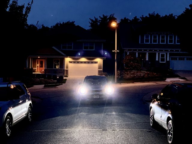

These are almost twice the brightness of the original led bulbs from twelvolt and are brighter than the m2 bulbs. These bulbs are also 1/3 the price...
Just drove around in almost pure darkness and the lighting is great. No dark spots and the distance is pretty good.

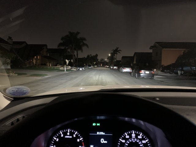

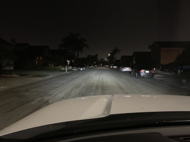

Had no need to drive to the nearest pitch black area.
The house in front of me is 12 houses away. With my naked eye I can see the beam on the house. The camera (iphone xs max) kind of catches it.
From my point of view my naked eye doesn't see any dark spots, but the camera catches something;
Moving my camera forward and facing down, the camera sees more of the dark spot;
Color matches halos;

Looks like from the driver's perspective the hood obscures most of the dark spots.
That's pretty much what I said. From my POV my naked eye doesn't see the dark spot that the hood obscures. However, my phone's camera at the same POV was able to see the dark spot.
You definitely see the dark areas when the camera is pointed down, but that's not where it matters lol. Adding a set of foglights will remedy that.

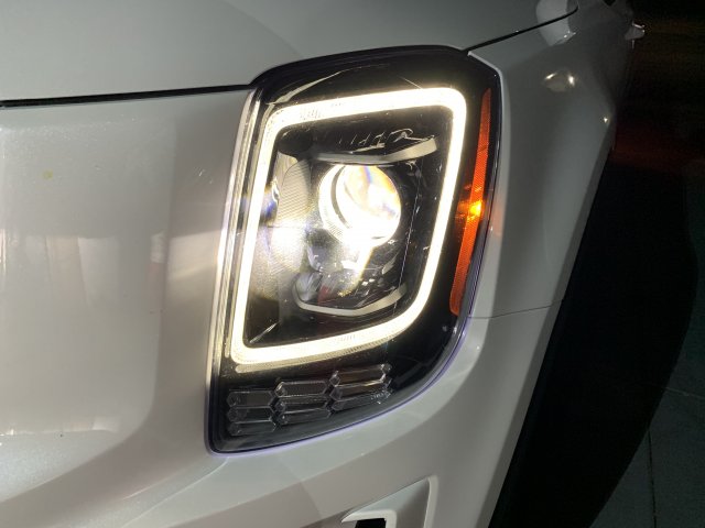

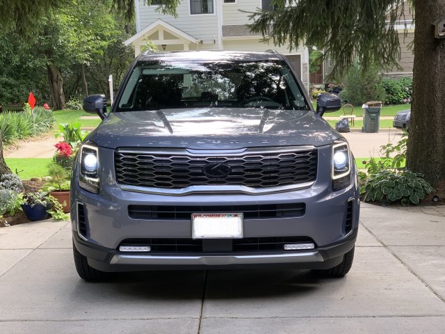

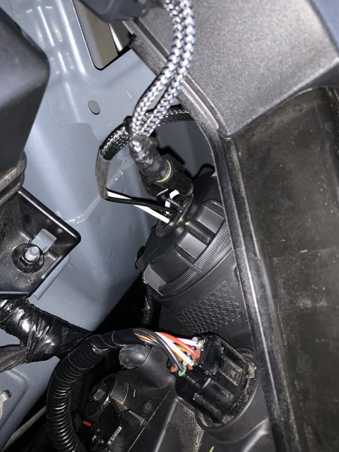

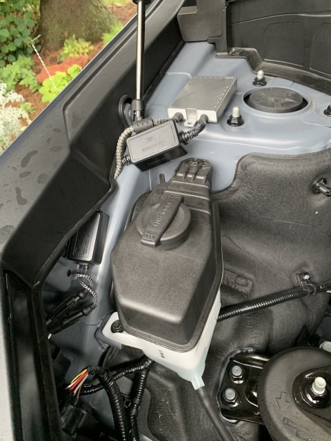

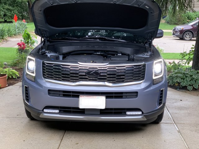

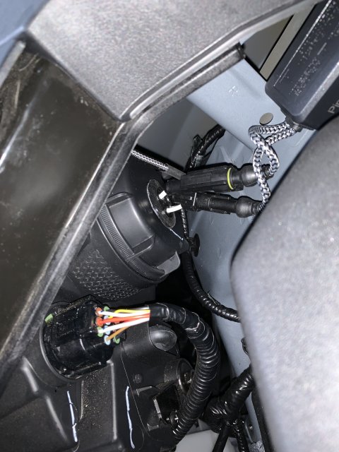

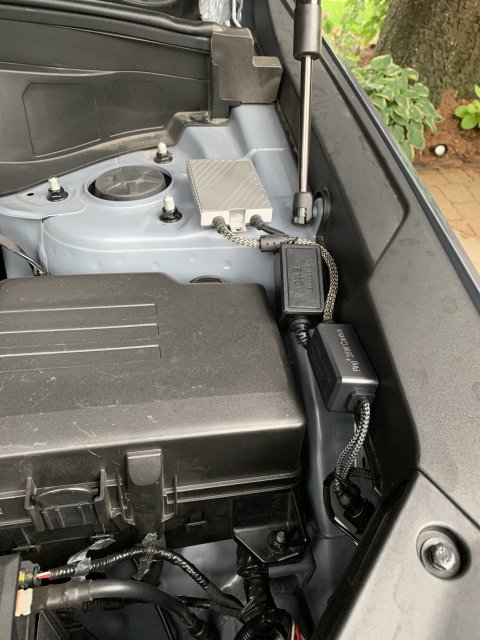

I'm not a fan of LED headlights yet. So I installed a DDM Tuning xenon HID kit. Here’s what I used: DDM Tuning Plus 35W Premium... https://www.amazon.com/dp/B01AJ11WFG?ref=ppx_pop_mob_ap_share
I attached some headlight shots plus a look under the hood. Kit took about an hour to install (including a 5-minute call with tech support).
If you want to see the brightness difference, look up HID installation or HID vs halogen headlight videos on YouTube.
Pure white and sooooooo much better illumination.
Pardon the pun, but there is a night and day difference from the HORRIBLE halogens...
PS: I had to contact DDM Tuning @ddmtuning tech support during the installation. I sent a webform Q and they CALLED ME back in under 20 minutes. We solved the problem in 5 minutes. INCREDIBLE customer service!!

Hey, how are the HIDs holding up? Any issues? Do you have any pics at night of how far the throw and the spread is? TIA
36
12
#98

Very nice setup. I noticed you installed foglights too, can you post some info on where you got it from?

Sorry - offline for a bit. The HIDs are great. No problems and like my other cars with factory HIDs, the light output is white and beautiful!
Amazingly I have no photos from behind the steering wheel. I was so happy at how well they worked I only took the direct-on photos (to look at color). I'll take some next time I'm out at night. The high beams light up the next county!
PS: I have not been "flashed" even a single time...
Actually just an old set of LED running lights I had in the garage. Most likely purchased on Amazon a few years ago. I wanted to see how easy or difficult my future mounting of fog lights will be. These LEDs are not connected...
