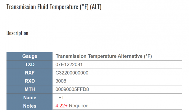

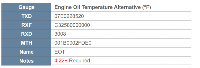

I got the scan gauge to work on the Telluride! I have these readings set and working on my screen: Engine Oil Temp, Trans Fluid Temp, Water Temp and Horsepower. The codes for Engine Temp and Trans Fluid Temp are attached. Now I can get some baseline readings to compare against when I tow. I highly recommend this device, just takes a while to figure out.

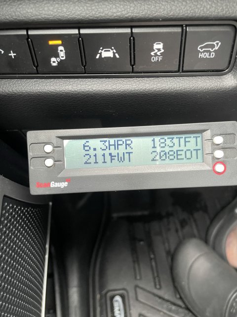

Maybe this will help, these are the driving around town readings I got today.
Wow, I feel like even the coolant at 211 is awfully high. Only other thing I have a digital gauge on is my Jetta, and it never makes it past 195 on a 100 degree day and the boost turned up
Not concerned as the dash temp gauge has always been on the cool side, its probably due to where the sensor is located. If its in the discharge path going to the radiator that could be quite normal as it will be the hottest there. The idea is not to worry so much about the initial readings, just develop a baseline set of data during normal operations and then anything significantly above that (when towing) should be carefully monitored to avoid overheating the engine and transmission. Still waiting on my RV so that won't be happening anytime soon.

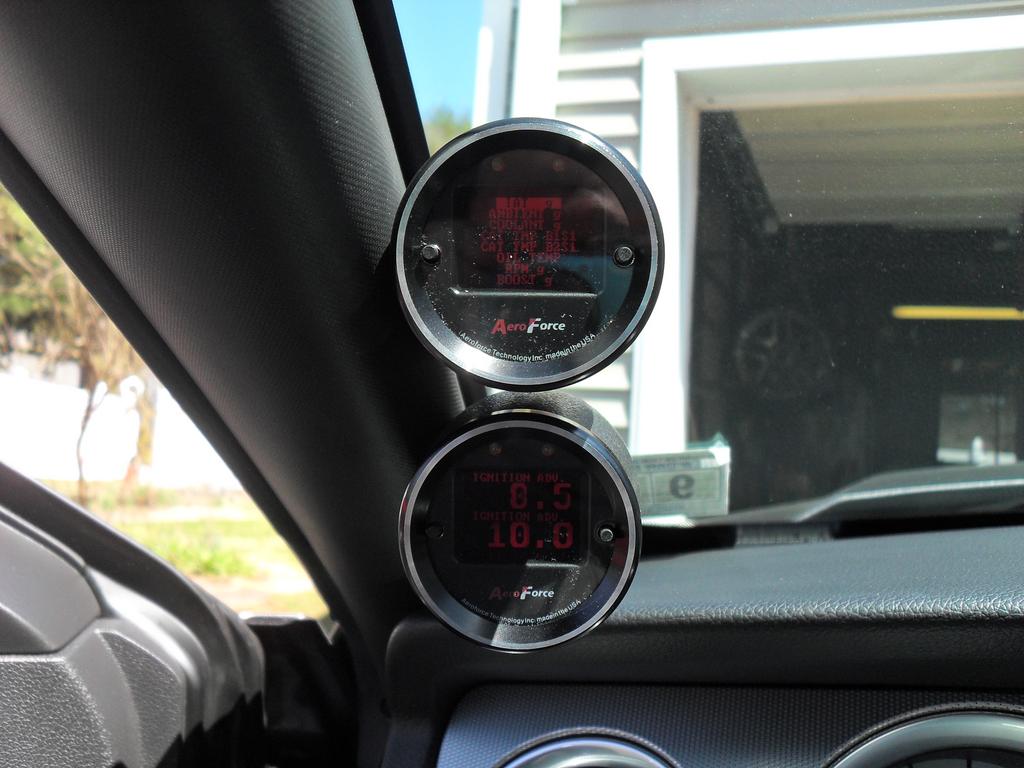

I use this to monitor several different areas on my 14 GT500, plugs into the OBDII port, what you monitor is selectable.
Might be worth looking into..
AeroForce makes one for Kia.....( www.aeroforcetech.com )
