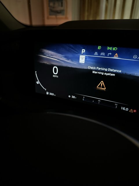

Just bought this car for my wife. Had it 7 days and this parking distance error appeared on the dashboard and the warning quit working. Took it to Kia the next day and they have now has it 8 days and have involved Kia engineering to try and solve it. Hoping this is not a recurring problem because she loves the car. 6809179C-3B8B-4408-9F75-F2B6D5159B09.jpeg

Been two weeks now. Still nothing. Saying it is not communicating from the front to the rear or visa versa.🤷🏼‍♂️
