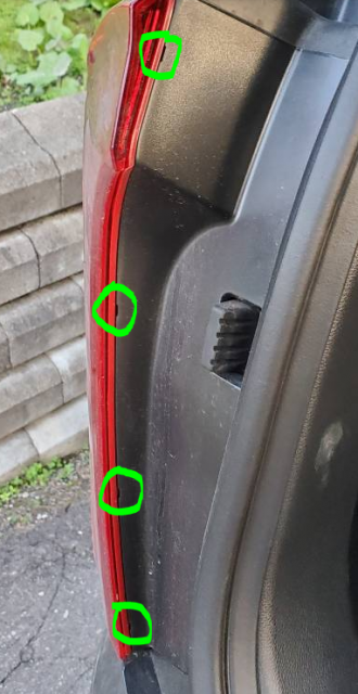

I took a look today to see what effort it would take to remove the bulbs... I dont even see what panels need to be removed to access the tail light????
Looks like it's held on by two screw at the top. Do you have a picture of the lamp assembly with the tail gate open?

This is what I see

This is what I see
Sorry, it that obvious is it? I don't understand why KIA doesn't make replacing incandescent bulbs obvious and simple! It's just like the backup and side marker bulbs!

335
Use a flat head and pop the cover off. Haven't tried yet. so test it for us.

I didnt have time to actually do the bulb transfer but seems like a very simple job here is what under the black panel
